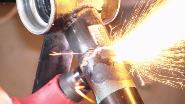

     thank you for all the suggestions guys but I have decided to go with a company named longevity which had a great selction on welders and plasma cutters all backed by a 5 year warranty so I am going to post some pics of my work so be sure to let me know what you think.....
  • July 1, 2011 2:48 PM PDT
    Pic 2 looks a little cold, pic 3 a little hot. wrap something around that tube to guide the side of the plasma head. That weld in pic 2 you probably could have done with little or no filler rod - just fuse it. Try it.
  • July 2, 2011 12:25 PM PDT
    Barry, like GaryTJ said, he's giving good advice - When purchasing a machine, brand name (Lincoln or Miller) is the way to go. You can def. associate cost w/ value when considering the machine. Also bofahs is correct, in pic 2 either your too 'cold' or your not moving fast enough. That weld should be 'laying flat. You may want to experiment on another piece (part. if this is your final job) before you begin welding again. Additionally, to prove bofahs point/comment....you can 'slice' through the welded material (that is, take a cross section) and check your penetration - you will then see for yourself if you 'fusing' as it should be done.
