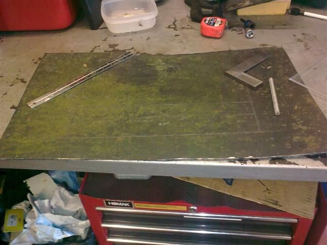

From the moment I got my night train in 09 the rear light PLASTIC bracket just F**KED me off.
Reason 1. it is plastic. reason 2. it supports a lugage rack that can carrysod all weight. reason 3. it looks wrong. reason 4. it is plastic.
So here is my very simple solution.
1, Mark out your falt plate after making a cardboard mock design.
2. cut it out and trim accordingly to make fit....don't trim too much at one go, keep offering it up to check you are going in the right direction.
3. When you have final fit, mark for light and plate holes.
4.dry run fitment and then when satisfied send off to powder coater or chromer.
I will put up the finished one when it returns from the powder coater during the week.
Simples.

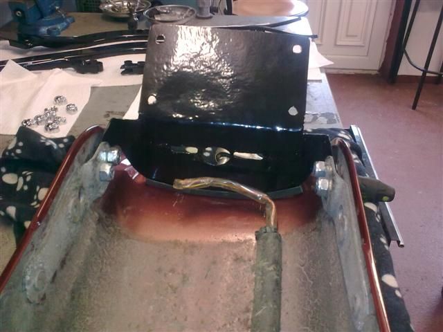

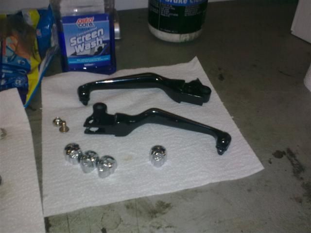

The parts arrived back from the powder coaters at the week-end now all remains for me to do is re-assemble the whole lots.

The rear bracket, fender struts and levers cost me 90 euro to get powder coated.....don't know what that is in Dollars.

February 4, 2011 1:53 AM PST
Re-assembly took place yesterday and it turn out grand.
