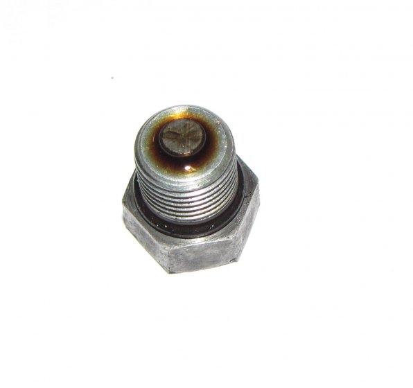

    Bought a FXDL new in July '06 with 2 miles on it ('07 model) and expect to pass 100K before year's end.  As the bike gets older I spend a bit more time paying attention to things I earlier might have taken for granted.  Much like my own body as years add up on me too.
    Wanting to keep it stock I've changed the hand grips twice, brakes once, fork seals once, God knows how many tires and the low beam went out once.  Oils been changed like clockwork from day 1 with Syn-3 (fricking $25 qt in Europe) everywhere.  Uses about 100ml (3-4 ozs) between changes a portion of which winds up in the air cleaner and on my pants leg.  And very seldom do I ride down dirt or sandy roads.  Plugs burning clean and last oil change mag plug was clean as a whistle.

    Pics at 88,600 on bike and 10K on plugs
