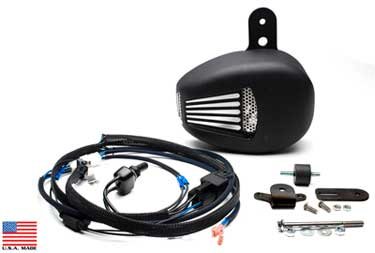

    Thinking of purchasing this new fan it looks great fiannaly.  Need help is it working like they advertise or not. I will be putting it on Road Glide Ultra 2013.
    JIMS® Forceflow Cylinder Head Cooler
    "This smooth streamline design will keep your Twin Cam® running cooler on those hot July summer
    days in stop and go traffic. JIMS® R & D department has come up with a serious way to drop your
    head temperature by as much as 100 degrees. Although this mounts in the horn area JIMS has designed
    a horn relocater hidden inside the fan housing. The fan can be installed to be turned on and off
    manually or it can be regulated by a thermostat controlled sensor that monitors head temperature and
    activates the fan when engine temperature rises. This kit is highly recommended for performance
    motors to help extend engine life. Complete kit includes high powered fan, housing, horn, hardware
    and all wiring, along with detailed instructions."

    Stan, The question of the HD v-twins running hot has come up here and everywhere else a lot. I always go back to the fact these motors were designed as air cooled and designed to run HOT. Sure things like syn lubricant and oil cools will lower that temperature a bit, but whether it is necessary or not is a whole other question.
    To me this looks kind of like a gimmick product. I am sure under certain conditions they can get it to cool just like in that chart. But I can't imagine that when you are moving this could provide more air flow thru the fins than what occurs normally. And if you are stopped for that long... shut the dame thing off. It's just the push of a button to start it back up !

    Nice to have at the sturgis rally. I think it's kinda spendy $420 at JP Cycle. Found a LeNale cooling fan on EBay for $229. They both look like a $9 computer case fan with a chrome housing.

    That's probably what it is since computer case fans are all 12 v.  Guest the other $410 is for the housing!
    Like a lot of the others said, looks like a gimmick.  Been riding air cooled v-twins here in Arizona forever and haven't had one die from heat exhaustion yet.  Normally the rider with suffer heat exhaustion before the Harley!

    I'm of the mind that the danger of overheating is not going to be alleviated by a blower that compares unfavorably to a hair dryer. The areas that would be most needful of supplemental cooling would be the upper end of the cylinders [that is where the slugs would like to seize if forced to]. The innocent little device pictured cannot possibly do a 360 degree coverage on two cylinders. About as effective as a fat lady exhaling before she gets on a scale. When was the last time anyone heard of a stock, broke-in, Harley that scuffed it's bores from stop and go riding?
  • September 5, 2013 3:24 AM PDT
    I wouldn't think a little computer fan like that would do a whole lot blowing on just one little area.
